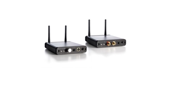

I found this through an internet search - not sure if it’s available here. Also, it is over designed (has a DAC as well as USB-SPDIF converter) for my need. Still hoping there’s something out there for this peculiar need and someone here knows! 🙂
Hope this is a trustworthy Indian reseller. Shall speak to them tomorrow:
looks like a good component but considering the speaker does not have any other inputs other than wireless how will this connect ?
Hmm. I am hoping the speaker can catch the Wi-Fi signal from transmitting piece (like from a Wi-Fi router) and I won’t need to use the receiving piece. That’s what I want to check with the seller.
