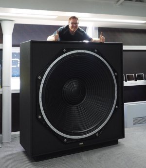

Neighbours' Envy, & Annoyance, all wrapped in one. The Ascendo SMSG50.
