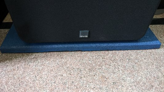

they look like this. A dealer in HYD sent me small pieces (at no cost)
I also tried this one and difference is very noticeable. Thx @prateekatasniya for this useful tip.

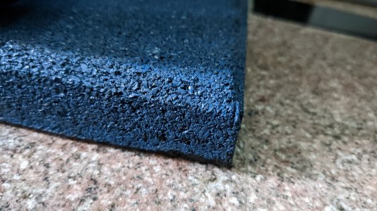

Recently I too purchased the Gym tile. It surely does the trick at a fraction of the cost of the SVS soundpath subwoofer isolation feets. It does weight around 5kg for 50×50cms, perfect size for my SVS pb1000.
