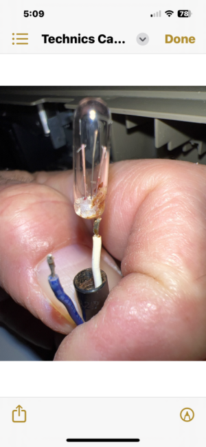

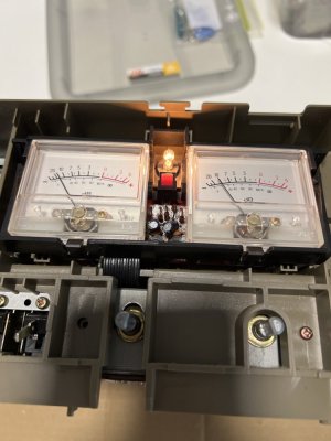

I have been trying really hard to fund the Light bulb Valtage and size for the
I have Technics SA380, capsule sized Bulbs works on 12VAC . I can see 3 bulbs but don't know if they are in series or parallel. If u want I can de-solder it and send it to you. With time their pins have corroded. Alternatively you can use LEDs

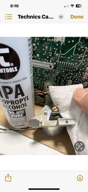

The Head looks little bit rusty due to storage First clean it with IPA 99% Then Take Autosol ASL_POL Metal Polish clean it with Q tips it will look shiny

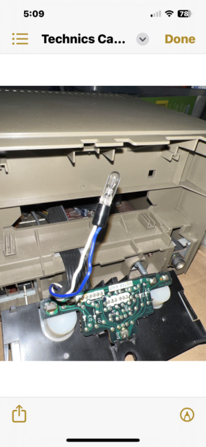

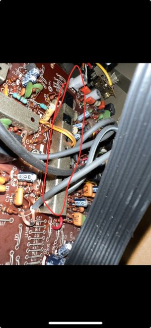

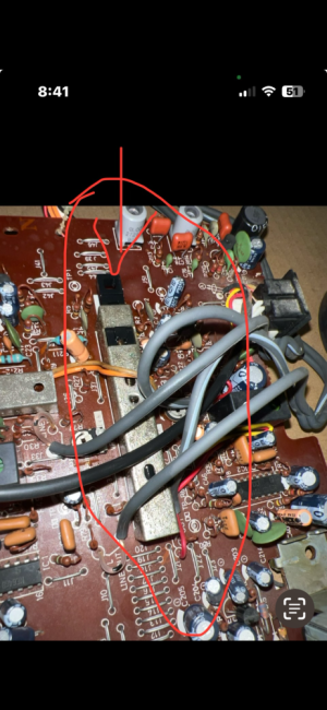

Fully unscrew the front of switches 2 screws Remove ,Remove Remove 2 screws from PCB then remove Tab holding RCA wires You will get PCB out to get to the Playback switch

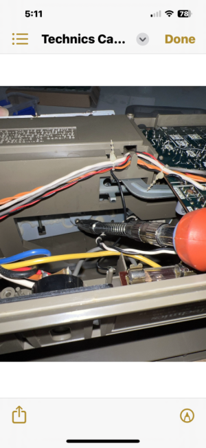

Use 6v 200mA Bulb in deck it comes with wires not 12v like shown picture
Hi Spanchal

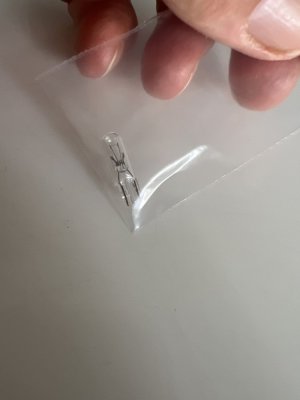

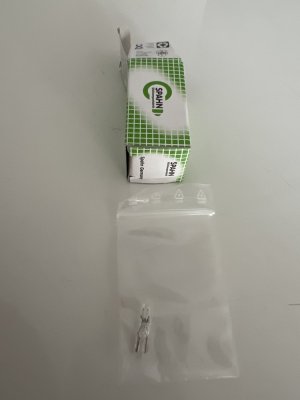

I received the Bulb and it didn’t come with wires !
See picture
It’s just 20c bulb they ,sell them on AliExpress with cables
I don’t know how i am going to connect this bulb
As it needs 5mm soket
Can the old one be pulled of from the socket ?

Hi Spanchal
See picture
If the bulb fits in the old socket then TRY that ,If it doesn't fit then buy required socket Also you have option to take it to deck service mechanic to do the installation of bulb Actually the bulb comes with wire
I can’t see any wire here it’s just a bulb ! That’s why i ordered it
I see how i go

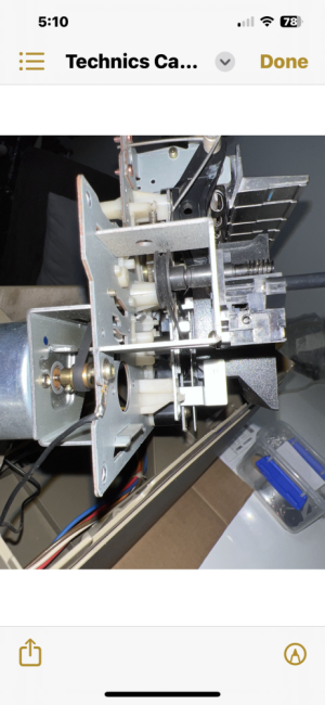

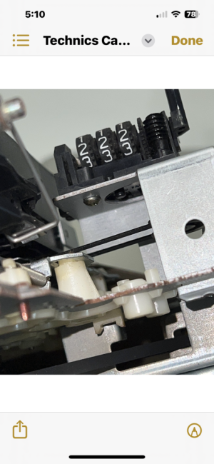

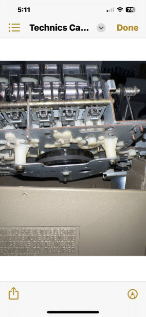

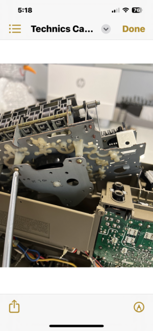

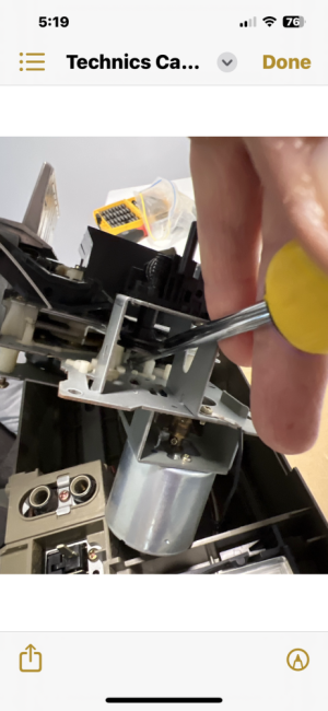

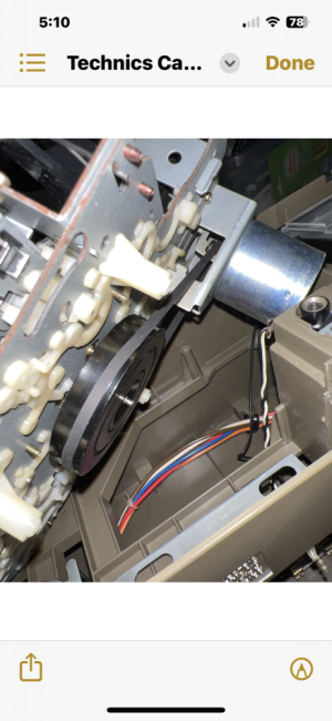

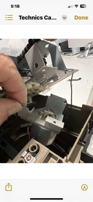

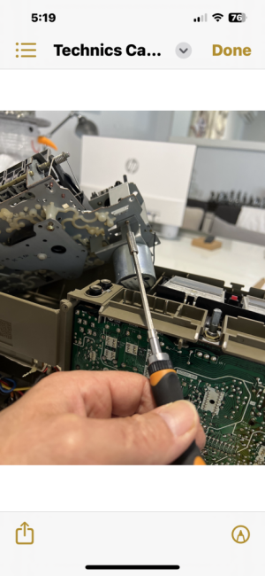

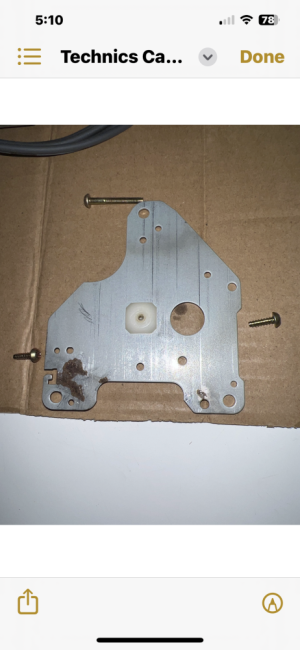

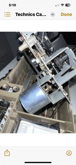

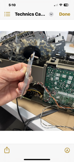

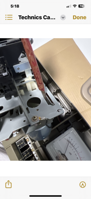

I replaced the belt
By removing motor x 1 screw and unclipping from plate
And unscrewing plate 3 x screws that holds the Big Wheel

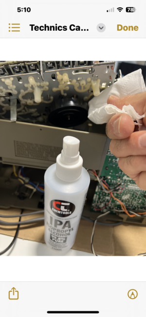

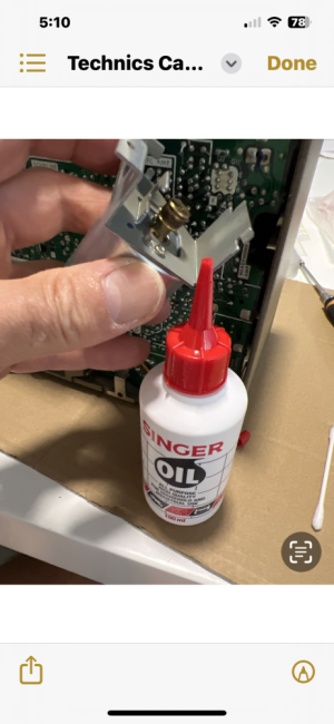

Oiled the motor with TT Sawing oil, and wiped all moving belt parts with IPA ,motor spindle,wheels,head,
I waited to dry for about 10min
And put it all together
Its very fiddle without unsoldering cables but it is doablešŸ˜€
By using deferent types of philips screwdrivers and loosening some of the wire so you can angle the main unit to get to screws
I attached hips of photos
If anyone needs more , just let me know

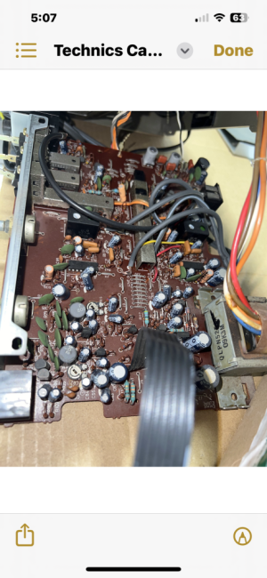

Now i want to remove the main PCB board so i can lubricate the main switch as perā€ spanchat ā€œadvice😊
But it is so fiddle and is running good , i am contemplating ?!
What you recon Snapchat ?
Defiantly no thought was put in for future servicing , when they were designing this unit 🤯
As it could of been such a simple thing to do if just things came out more simpler !

Ok

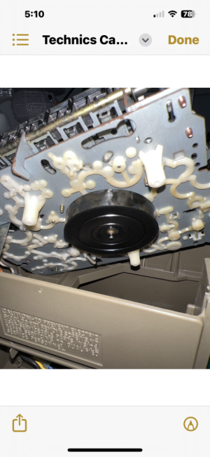

I fallowed through as per
Snapchal
Lubricated Record switch and all pods with DioxIT
See pics
And the deck playing really good
Surprisingly has such a deep bass
