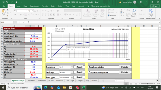

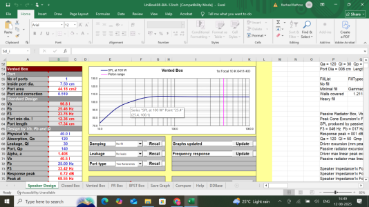

The point I was making is this,
lets compare B&C 100TBX100, excellent LF driver with 95dB sensitivity, give 100 watts and see the SPL at the ported tuned 25Hz, in 40 litres, gives about 103dB
Now, lets take a home driver in same box/tuning, it has sensitivity of 87dB only, it gives about 100dB
Vast difference in sensitivities (8dB) but very less difference in real use case at 25Hz, just 3dB. 3dB for bass is almost nothing.
I am not against pro audio drivers usage above Fs, I know they shine where the real sensitivity helps it a lot but for subwoofer the advantage wears out.
