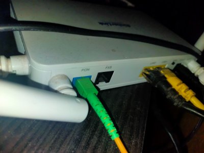

Why not post the pic here too ?
Just did..I keep on editing my post even after folks have replied. Pls see the pic in the previous post of my router. As you can see ..input is PON and out is two RJ45 ports..I am hoping one of them is gigabit.
3) Output from PON box to my router is PON again I am guessing or whatever the NON RJ45 thing is called.
Interesting! I’ve never seen a router with an OFC snap-in input before.

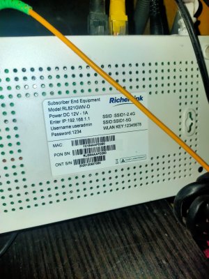

Addressing your original query as I was confused with your phrasing. Here's where it got confusing, the interchanging use of terminology.
I currently have a fibre to Pon to router ...the output from the PON box/modem is also PON as input to their router. Hence I cannot use any of the 3rd party routers as they all need RJ-45 as input.
  • OFC (Optical Fibre Cable) drawn to your home is connected to a Fibre Optic Splitter Box (the white box which you have pictured in your techenclave thread). This is the first point of termination of the OFC in your home.
  • This cable is then terminated to a Single Core Fibre Optic Drop/Patch cable (thin yellow cable) which is inserted into the PON (Passive Optical Network) socket on the ONU (Optical Network Unit/ Optical Modem), which you mentioned as a router, hence my confusion. Although you're not wrong, ONU can also have an inbuilt router functionality (just like your current ONU).
In this case, ONU is the Optical Modem, and the PON Box which you refer to is called the OFC Splitter Box.
I have been trying to contact Excitel customer service to give me some kind of a modem which has a RJ 45 output...but their customer service is useless.
Your modem (ONU) already has an RJ45 output.
If you search for ONU with router functionality you'll get plenty of results, one example being this
It is possible to change the ONU, provided you've taken a screenshot of the device's settings so that you can feed them back on your new device.
Most of these ONUs with Wireless functionality are not the best. You have done the right thing by just getting a new wireless router, it's the easiest fix!
