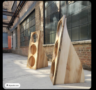

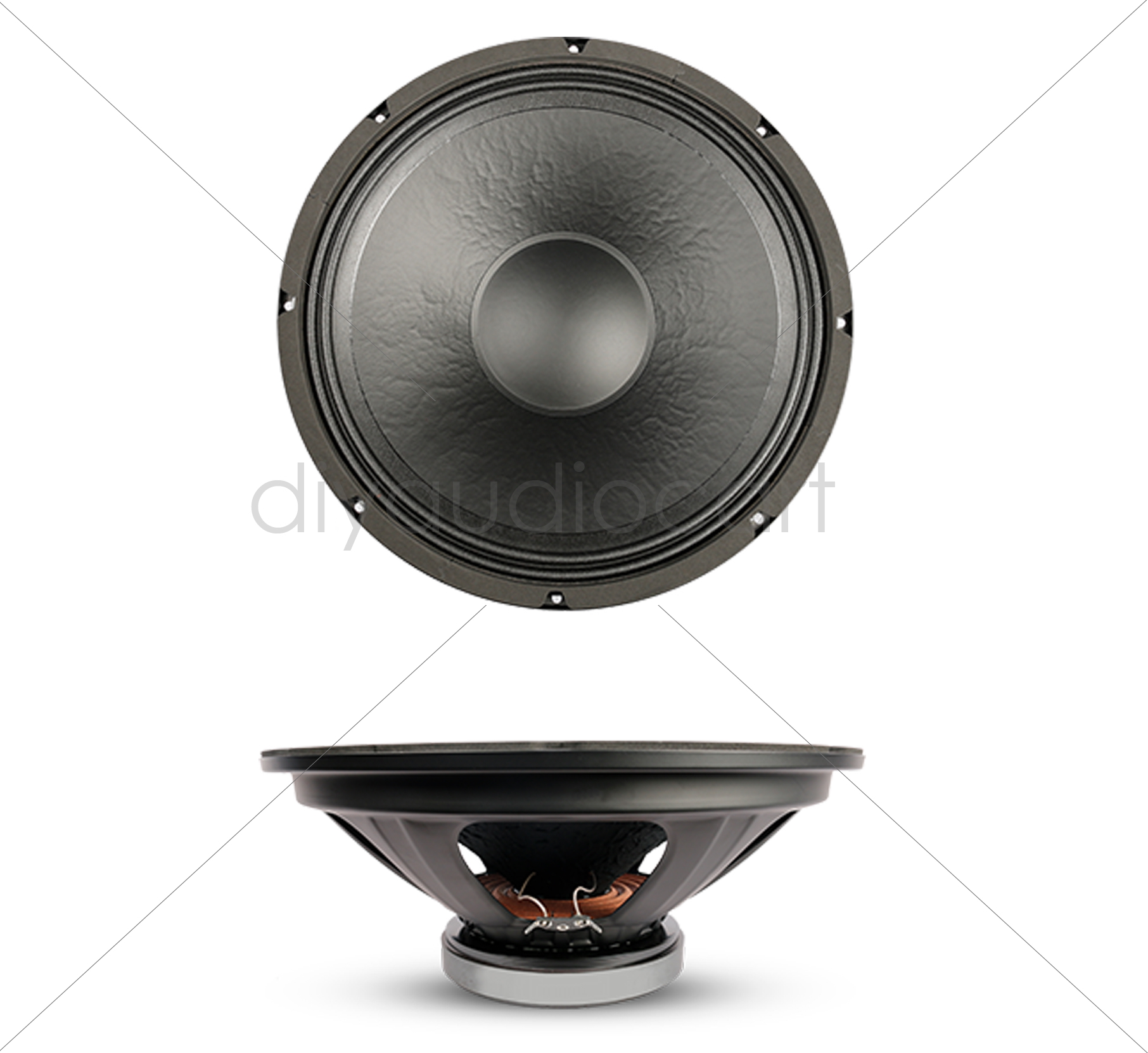

The amplifier power required will depend on the effeciency of the woofer. If you have space to accommodate an open baffle subwoofer, then these are very efficient and dont need much power. SB Bianco OB350 will be perfect for the job :
Below is a more compact deisgn with the same drivers, originally posted by @aeroash .
