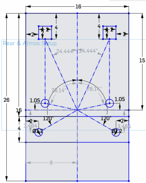

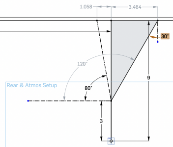

Regarding positioning I'm thinking of the following.
- Top black line is the ceiling.
- Listening is approx 3' from floor
- Acoustic ceiling bottom is at 9'

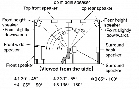

Rear surround is about 3.5' behind (tweeter angled) and Atmos is 1' in front. For Atmos using this page as reference (https://www.dolby.com/en-in/about/support/guide/setup-guides/5.1.2-overhead-speaker-placement) and the rear surround is roughly placed using #4 as a reference from the bottom image.
Hi, regarding placement, please focus on the angles to calculate the Atmos ceiling positions instead of distance. I'm also working on a similar (5.1.4) setup and found that the angles are most important for Atmos.
If you want the front height channels only, your ideal speaker distance from the listening row should be [6'/tan(30 to 55)] = 4.2' to 10.4' in front as per the tolerance specified in Dolby specs.Similarly while calculating the width, it will be similar only the acceptable angle ranges from 30° - 60°.

I chose 80 degrees for the Atmos based on Dolby 5.1.2 specs.

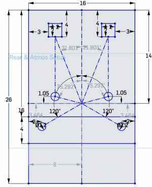

While the Atmos is shown in line with the front L&R, the rear are shown closer to the side walls. I have tried 2 top view simulations shown below. The L&R distance from side wall is different and also moved the listening position from 15' to 14' in one. In both I choose 120 degrees horizontal angle for the rear surrounds then I get 40 degree vertical angle separation between Atmos and Rear (120-80) as shown in my earlier post which is fine according the video you shared.

Unfortunately, if you are using height channels, putting rears or surrounds at a level higher than 1.25 times the front LCR is not recommended. However, since you had mentioned that on wall is not an option, I suggested to move them at least to the side (within the 90-110 degree horizontal angle).

The angles in the last post look fine considering your constraints. However, if you decide to go 5.x.4 in future, I would suggest keeping them @ 110 degrees instead of 120.
Another thing is that the atmos heights need not align with the front LR. They need to be at an angle of 30 to 60 degrees from the MLP (look at around 6:35 mark in the first video).
