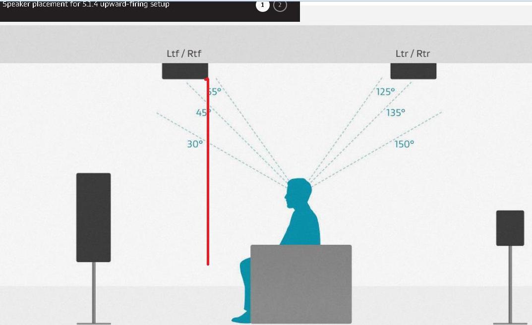

For a Atmos height set up, they recommend approx. 45 degree from front and back..so it implies that H-front and H-Back should be deployed ahead and behind you sitting position. Now if I go by your suggestion to deploy one pair of Height right above my head...wouldn't it cause a problem when I plan to upgrade all 4 heights. Please suggest.
Sorry, i didn't mean it to be right above your listening position, but slight in front should be fine.. Here is the guide for 7.1.2 layout - https://www.dolby.com/us/en/guide/dolby-atmos-speaker-setup/7.1.2-overhead-speaker-setup-guide.pdf
For 7.1.4, one pair of heights in-between the fronts & surrounds and one more pair of heights in-between surrounds & surr back should do - https://www.dolby.com/us/en/guide/7.1.4-overhead-speaker-setup-guide.pdf
Should this be fine for front height.
only tweeter can be tilted by 15 deg.
There are some angled in-ceiling speakers too.. Not sure by how many feet your top front speakers would be from your listening position, if you feel you need more tilt, then consider mounting it little closer to your listening position..
