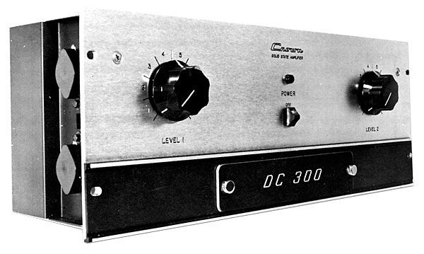

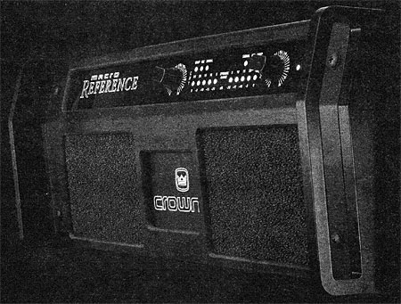

The latest Crown power digital amps are really good and work like a charm. Here also copies available...

If you crave for that punch and sizzle, then one way to get closer to it is to assemble a system that has live music heritage. Speakers like JBL, Klipsch heritage that has larger woofer cones. You can even drive them with amps like crown. The new digital ones are quite nice. Add a parametric equalizer into the mix and you are good to go. Best of luck.

A lot of pro-audio companies make audiophile gear anyways. JBL, Klipsch, Bose, Yamaha to name a few. Most home audio systems I have heard are underpowered lack those Dynamics you are talking about. I am a firm believer in having as powerful an amplifier that you can get and see the difference. Home audio speakers and a pro audio amplifier can give you the sizzle and slam without the headache. No wonder large speakers like Klipsch heritage are still in demand.
