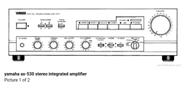

Evening Folks,
Would like your take on the YAMAHA AX530 stereo Integrated amplifier (1989) . A friend of mine has the amplifier lying around neatly stacked and cared for since many years ( looks very neat even after decades of use), however he hasn't used it for 3-4 years and now has plans to dispose it for around 15k.
Does anyone have an idea bout this amplifier or may have used one in the past ?
Would you suggest buying it around 15k and would it be something worth owning in 2022-23 ?
What are a few basic things to check if it's in good condition & what are the parts that may need to be replaced once I buy it ( since it's nearly 25+ years ).
Kindly request FM's to share their inputs incase they have owned or used this amp in the past or are familiar with Yamaha amps from the 90's.Thanks in advance.
Cheers.

Specifications​
Power output: 85 watts per channel into 8Ω (stereo)
Frequency response: 20Hz to 20kHz
Total harmonic distortion: 0.01%
Damping factor: 80
Input sensitivity: 0.16mV (MC), 2.5mV (MM), 150mV (line)
Signal to noise ratio: 76dB (MC), 92dB (MM), 102dB (line)
Channel separation: 60dB (MM), 60dB (line)
Output: 150mV (line)
Speaker load impedance: 6Ω (minimum)
Dimensions: 435 x 141 x 332mm
Weight: 7.8kg

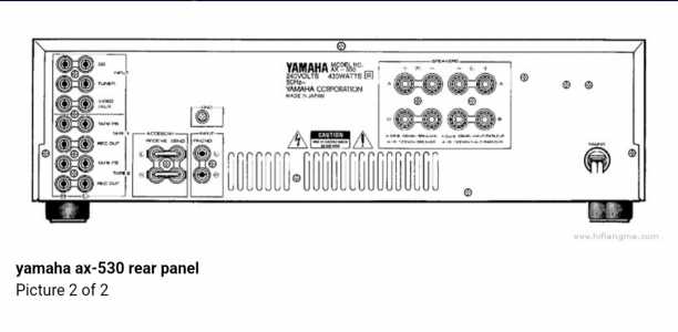

My friends have the AX592 and AX890 respectively. The Pre Outs & Main in were used mainly to connect an Equaliser. Direct Main In of the amp serves as a power amp. These amps were purchased in 1994/1996 and are still running flawlessly till date.
Hi, my amp is the same I think. Let me check tomm in the attic. Coming to the imbalance i never even tried to rectify hence no idea what to check.
Most of those vintage Amps featured preouts which allowed using them as a preamp or power amp improving the flexibility. However you need a subwoofer that allows line level inputs to use with this amp. If the amp has additional L&R preouts as you said then the subwoofer choices will be more.
All in all if its in pristine condition and sound good as you said, I suggest don't get too worried about the internals and expected failures.
If you have to buy a modern amp boasting such power you may have to shell out upwards of 60/70K. So enjoy the amp till it lasts. Cheers
Wow....indeed sweet of you to update regarding the pre outs.Would i be able to use one pre out to a subwoofer ,incase i plan to add one later ? Glad to hear that these are running well even till this day.Its reassuring to me that i can still pick it up if it's in good condition.Happy New Year to you and fly in advance.

I have no clue about the L&R preouts. According to the pics in the manual it has 2 sections - TAPE A & TAPE B, There's a preout below Tape A & another one below Tape B. ( 😁absolutely clueless if this can accomodate a sub or not) but I'm sure we have FM's who will know for sure what these are & I'm hoping they enlighten me.

Hi, those Tape preouts will output only Tape signal and not all sources. But you can still use a subwoofer with this amp. But select one which allows line level inputs. You can check videos on YouTube for more details when you need.
