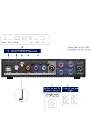

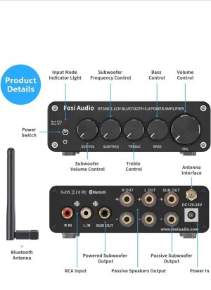

These are the two amps suitable for your budget. but Fosi has 2.1 out and Aiyma has remote, as you mentioned, but it has only a sub out. If I were you, I would choose the subwoofer-out option and go for an active subwoofer. If you upgrade this 2.1 amplifier to any class AB amp, your passive sub will need another amp. Always active sub will be a good option in your case.

aiyima claming 24 bit on digital input options . but fosi has this option in there higher model it cost 25k

1000012368.jpg1000012366.jpgits mention that both have a active (powered) subwoofer out....

Upgrading to a class AB stereo amplifier with additional subwoofer amplifier will be within budget. Otherwise cost of active subwoofer can be more than the entire budget. If budget is not an issue one can go for active subwoofer.
