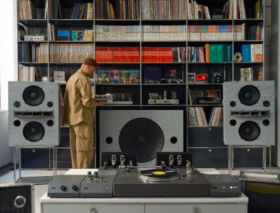

You should ask Devon Turnbull to make you one of those short throw but large subs :)

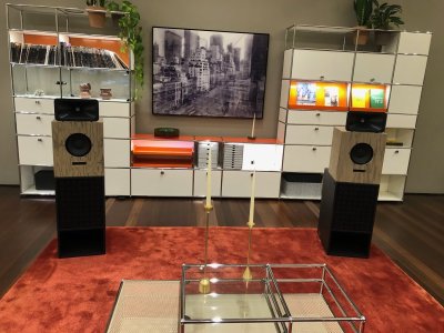

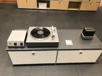

Visited his studio in Manhattan last year. He seems to be into interior designing too. The big 21” Fostex woofer was missing though.
That's nice. How did you find the sound ? His background is in creatives but he being a lifelong audiophile who is genuinely interested in the non mainstream side of audio has carved out a niche for himself in the space. He has deep connections in the underground Japanese audio side of things. I ran into him many years back by chance when he did an exhibition in Amsterdam. I was just walking past and saw it and walked in. Those days it was more of an art installation. Nowadays he seems to have taken it to the next level.
Was slated to meet him in my first week of arrival in NY but Covid got good hold of me and kept me bedridden for 10 days (and American grave seemed imminent).
However managed to visit his studio in last / fourth week of my stay and he was traveling at that time. The setup was simpler and sounded crisp and clean.

What is the speaker setup? Some what resemble mine?

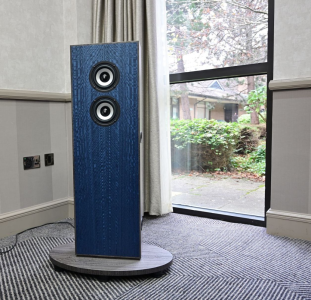

Ted Jordan, the designer of Axiom 80, used a MJ Acoustics sub for his listening at home. It’s his recommended sub. So I am assuming there is a good chance it will work well with the Axiom 80.
The model he used is from 2008 and that’s the same one I am trying to get my hands on. Failing which I will get a model from 2017 which has the same specs.
The sub uses a 10 inch doped paper cone driver in a sealed enclosure. Amp used is a 120 watt MOSFET amp. All controls are in analog domain.
Coming from the designer's own experience, you will not go wrong. I think it is the same gentleman ( tall older gentleman who said he is the designer..dont remember his name now ) I met in the EJ Jordan room at the Edinburgh audio show. One of the best sounds at the show. Devoid of any untoward hifi artefacts!
You must have met Colin. Ted Jordan passed away 6-7 years back. It was Colin who told me about the equipment Ted used at his home.
Ted Jordan is considered god by many. Even a genius like Yamamura went to Ted to get drivers designed for his horns.
Yes, I guess it was Colin. These people tread a different path and the results are amazing.
