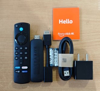

Received the Amazon Fire stick 4K yesterday evening. Now waiting for Tobo HDMI Audio Extractor which expected tomorrow.
