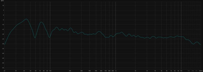

I moved this past November and while I've treated the current room also, there's no wooden flooring - the pitfalls of renting. Now the RELs are rolling off more or less at their rated frequency of 28hz with some serious bass cancellation around 58hz and a massive peak at 44hz.

Nah! There's more than one and more effective ways to skin that cat. But wooden floors are a great place to start in addition to providing tactile feedback. The current peaks, dips and lack of extension has more to do with the room dimensions and the manner it's constructed which meant i couldn't deploy as much room treatment as last time.
Notwithstanding, i've still got a decent sound except the epic bass response is no longer a feature 😐. This is also the reason why I'm quite interested in trying out a trasducer to see if it can get some of that feel back. The only bummer is that i'll have to get separate ones for each seat or in the alternative, get a three seater recliner - the perfect one simply doesn't exist!

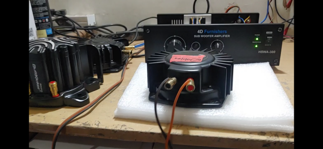

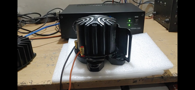

They look expensive. What's the going rate on these and where can I find them?
Someone had brought them to test with my amplifiers. There is some art exhibition in Mumbai and these are to be used to vibrate floor I gues with sensors activating them.
Sure they would be expensive and not available in India. You have to import from Amazon US I think or partsexpress if available there. But I would not recommend buttkickers as they perform well below 15Hz and there are a very few sounds in movies and music that are in that range. So it is better to go with Aura or Dayton Audio ones. Get in touch via whatsapp I have some more ideas. DM me for number. As bass shakers will still be too expensive for the effect they give.
