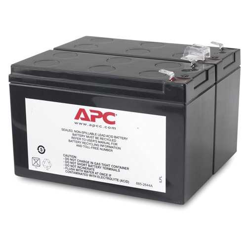

Found this, said to be compatible with SUA1000I
But now another question arises, if I buy these batteries, and replace the old ones with them and keep the UPS back in storage, as there's no use for it right now, would these batteries remain OK and functional or would they too deteriorate over time?
