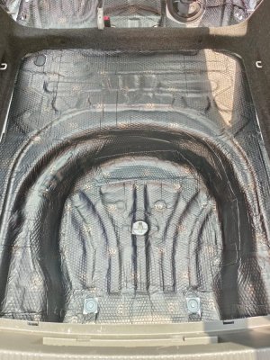

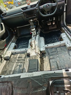

Morel ACUDAMP 221.10 2.1mm ( 10 sheets) Rs 8990. This was a reply to the cost of dampening. So 16K material + labour. Not Morel speakers

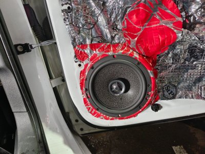

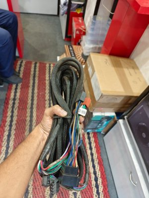

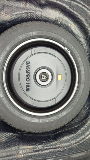

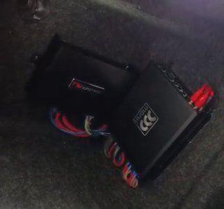

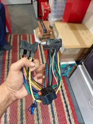

Some pics of the install

Factory HU, alpine DSP AMP, Morel components ( front ), stock (rear), jbl sub ( in spare tyre).

Dsp is Nakamichi NDSK 4285 AU.
AMP is Morel MPD4.100.
The wiring loom ( original) on my car was for a two way component set up, ( I presume its the same for your Slavia). So be prepared to rewire if you intend to go for the 3 way setup ( warranty issues? ).
My two way front components ( Morel Virtus 602) ,rear coaxial ( Morel Maximo 6.5) ,Amp, Dsp, JBL sub ( Bass pro) with the stock headunit sounds good. But you do need the dsp to be tuned by a proficient tech ( not by ear but RTA)

Hey, no problem, the nakamichi s power was insufficient to adequately drive my speakers so it is purely running as a DSP, signal is amplified by the Morel ,4 channel, two for the front components and two for the rear door coaxial.
Is double damping really required or one layer would just suffice on a car like Honda City?
Depends on what you expect from the damping. To prevent rattles from the doors, one should suffice. Start with one, add another layer if you feel the need.
P.S I've never done the entire car. Only doors and boot lid.
