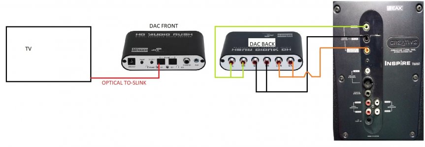

With my current setup, I get 5.1 (6 channels) decoded correctly. (except on prime video)
Hope adding this wont mess up that.
I just wanted to have the ability control volume of individual channels via remote.

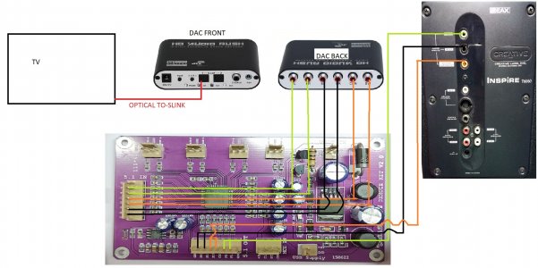

I have purchased 5.1 remote kit and tested by hardwiring and it works.
Now I want to put the whole thing in a separate box with proper connectors.
Below is what I have in mind, If someone could please review.

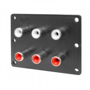

2 x MX 6 Way RCA Female Connector (MX-62). 1 set contains 6 connectors.
One for connecting the output from Optical to 5.1 analog DAC to 5.1 remote kit
Another for taking output from 5.1 remote kit to Home theatre.

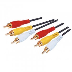

2 x MX 3 RCA Male Plug To MX 3 RCA Male Plug Cord Tip Gold Plated 1.5 Meter Elite (MX-1093M) . One set contains 3 cables with both end male RCA connectors
