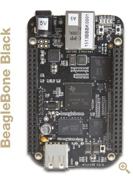

This BBB board has proper 2.0 USB port.

This one has 4 USB A type ports
Now if these ports were to be all be on atleast two different usb host controllers and there existed a usb wifi dongle that works flawlessly with linux I would go have gone for it. But nah... 4 ports on once controller, will mean interrupt sharing or at the least contention for the data bus again ... :cool:

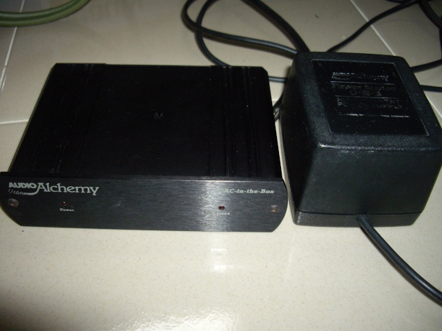

Unfortunately, my DAC doesn't have I2S input straight away. The only way to feed is to hack the DAC board. I am not seriously thinking about it and also I do not enough expertise to do that.
But yes, what we know about I2S connectivity, that should sound better than going through USB route.
