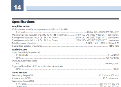

Whoa! Hold on to your horses big boy 🙃. 220W with only one channel driven or all channels being played simultaneously?
From your pioneer lx-87 manual. Its a useful guide unless its nicely settled in a bin 😋
To hear sound only from the pre-outs, switch the speaker terminals to SP: OFF (page 79) or simply disconnect
any speakers that are connected directly to the receiver.
It is also possible to hear sound only from the pre-outs by switching the AMP setting to OFF and setting the
pre-amp mode to turn the power amplifiers for all channels off (see Setting the Audio options on page 75)
- just in case i'm accurate on the bin part ;)
220watt x all 9 channels @8ohm impedance
260watt x all 9 channels @4ohm impedance
From the manual of the Pioneer LX87 😋
220W is for only one channel driven at 6ohms at 1% THD.
Power drops steeply to 130W per channel when driving only 2channels.
And no power rating given for all channels driven simultaneously. Probably closer to 50-60W at 0.1%THD :(

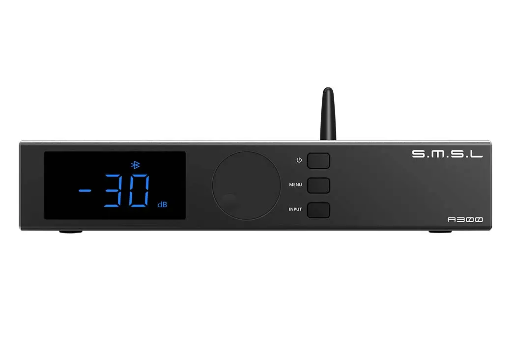

the superb SMSL A300 amplifer has finally landed and in stock

I can see some good reviews about smsl a300
Hope this will pair well with Elac DBR 62
