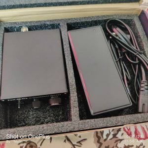

Just got the new upgraded AIYIMA T9 Pro version & Fosi Audio V3 delivered today.
Per some of the YouTube videos , Fosi claim to have lot better components with better heat dissipation design and better stability tests compared to AIYIMA A07. Looking to do Op Amp Rolling and testing this amp.
Has anyone tried using T9 / T9 Pro / A08 Pro as a preamp connected with AIYIMA A07 / Fosi Audio V3 via Aux connectivity ?
