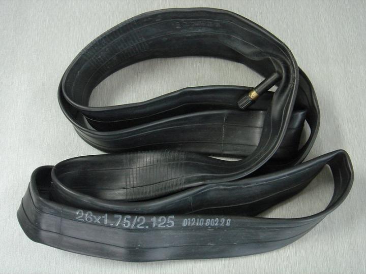

Prima facie, looked like a power hub to my entrant eyes! I would love to see the tubes in focus in picture!
Nice DIY effort, Captain!:clapping::clapping::clapping::clapping::clapping:
I am currently in search of "tubes" to be used as a "pre".
Cheers!
Hi Svenkateshsmart
Your prayers have been answered!!
Two of them (one for each channel) should send you into Sonic Nirvana!! :ohyeah: :rolleyes:
Capn.
How will the class D amp with the EI handle 'Metal' Genre of Music???
Hi Svenkateshsmart
