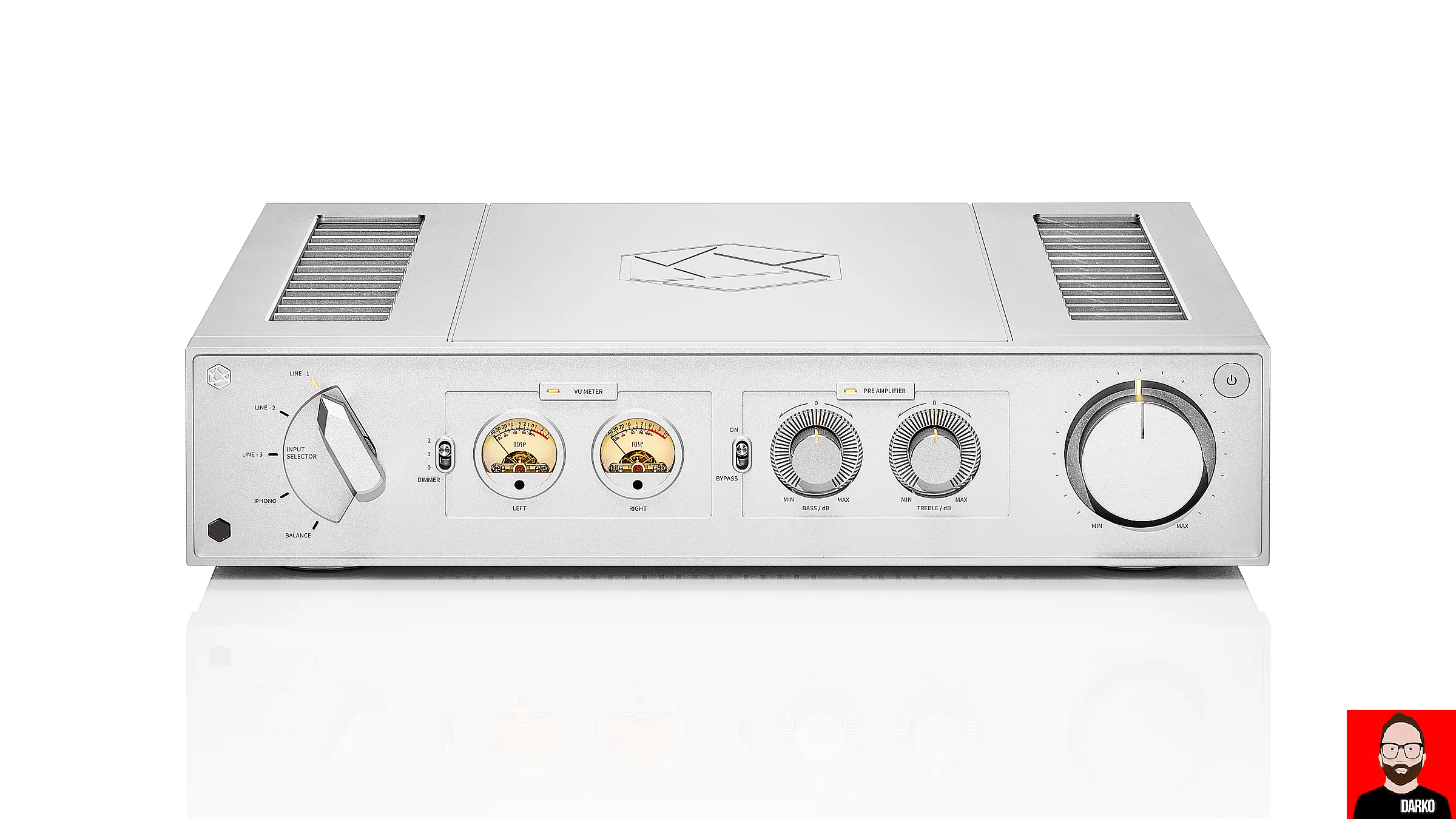

Srajan Ebaen has something to say about Class D amplifiers today. If you we can get past his style of prose writing I think he is saying…well, you can read it yourself here.🙂
I thought he was saying that too. But then mid article, I realized that he was not saying that but was trying to say something else. When I was wondering what he was now saying, I forgot what he was originally trying to say. I now find my brain tied up in knots that I'm trying to unravel slowly. When I told my wife this, she asked: "What brain?" giving my self esteem another kick. Srajan and my wife are particularly evil.
I couldn’t interpret the prose so got an AI to help
The HiFi Rose RA280 review on Darko.Audio discusses the performance of the RA280 amplifier, highlighting its ability to deliver detailed sound with a focus on the low noise floor. The reviewer notes that unlike other class D amplifiers that emphasize extreme detail, the RA280 maintains a balanced sound with a strong emphasis on the midrange. This is particularly evident in the way it handles vocals, which are described as "warm and inviting." The amplifier's ability to handle a wide range of music genres is also praised, from classical to electronic and rock. Overall, the RA280 is seen as a well-rounded amplifier that excels in its ability to produce a natural and engaging sound
Courtesy perplexity ai
