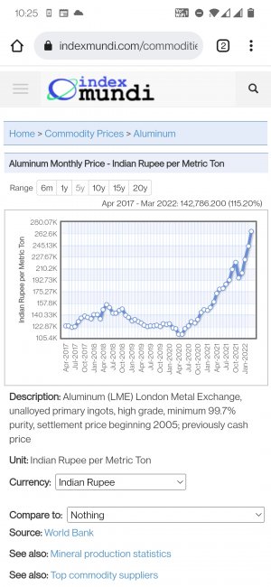

I was still under the impression that India was one of the major country exporting Aluminium ! strange Economics and its Dynamics!
I don't believe that a small fluctuations in Aluminium price would have such major impact in chassis cost. There may be something else which the vendor is not telling us.
It is always better to check facts before making an allegation.
This is bare aluminium. If you add in the impact of rising production costs, retail price of aluminium sheet has gone by a factor of 3x or more since before covid.

If your chart is correct, then it's just double the price for a metric ton. I don't think any chassis will weigh more than 10 kg. So if 10kg of Aluminium cost pre-covid was 1222/- then post COVID it will be 2880/- which is not very high to fret upon.
Btw, the scale on your graph is not very linear and hence show a huge jump.

This price you see is for ingots or raw metal and spot prices.
Provided your energy costs, wages, transportation, retailer's costs for his place, wages and all other allied costs including the tea you sip thrice a day remain the same, if raw metal price increases two times, chassis should cost twice. It doesn't happen and hasn't happened post covid. Everything has gone up in price.
The most recent preamp chassis I built is far simpler than a far more complex power amp chassis I built 3 yrs back. Yet the new one cost me more.

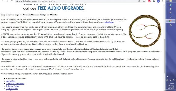

First of all,
CONGRATULATIONS for using zero plastic tie wraps inside the amp.
All tie wraps do ( sound - wise ) is co-mingle the differing fields around one wire lead to another wire's lead. slightly blurring and degrading the sound of both wires, wherever and every time a tie wrap is used.
Have you ever A-Bed this ??? I have !!!
Question, what is that red cylindrical device on what appears to be the red positive Output wiring off of each board, to the speaker output post ? What is it used for ????
If it is something like a ferrite bead ? If so, replace that lead with similar length and type of wire, with NO FERRITE bead, and give that a listen . Which sounds best ??
Refer please below, to the last two comments, from the late Pierre Sprey, of MapleShade Audio.
Jeff
