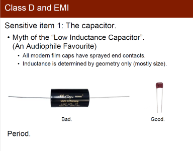

Below is from Bruno Putzey, the ultra low distortion class D amp Guru. His latest class D design has better distortion specs than the best class A/B amp for the same money. Of course, many may differ from this 'opinion'. I would happily change my opinion if somebody shows a measured difference between caps in between 20Hz and 20Khz.
