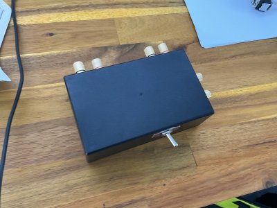

I do not have a seperate listening room, and these are the main speakers, for TV and music. So the magic switch is a saviour if and when I like to listen to just the main horn as full range.

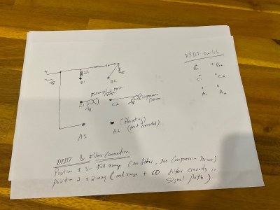

@grindstone
The previous hand drawn circuit with a simple 2-way switch has a major flaw. And will not work as intended.
was not sure what I was thinking when I drew this. DONT try the previous version, it was just an attempt at an idea.
Today I stared wiring them up and quickly realised where I was wrong, luckily I had not connected anything at that time.

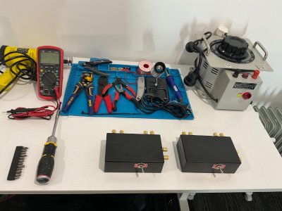

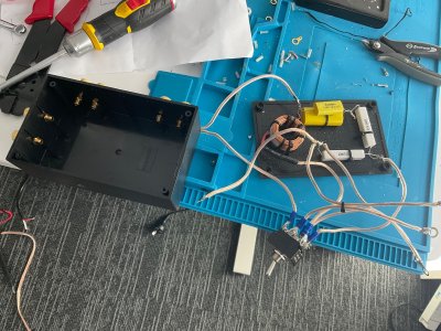

Today I re-drew the magic switch with a DPDT switch, and this works.
Cleaned up the wiring, test fitted, too it for a test drive on one channel, all good.
Finished both side magic switch boxes.
End of day results looks like these
