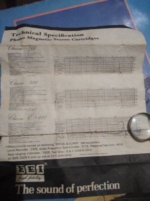

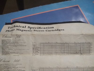

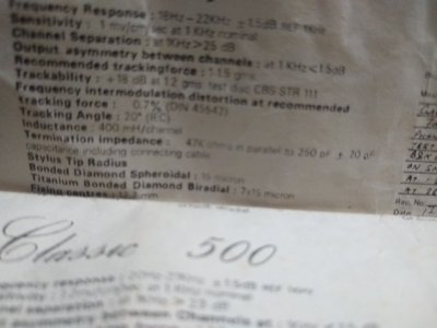

Sorry, but I disagree with this. The AT 3600 is a good entry level cartridge, but the Classic 700 has much more refined sound signature. I have purchased it since 1983, when these were current manufacture and very easily available. With the original eliiptical, high compliance stylus, fitted in a low mass arm and a good phono stage with low noise floor, the Classic 700 is a great cartridge. The negative opinions that are sometimes voiced are because what is available today is mostly fitted with some JUGGAD styli, and even if the stylus is original, matching arm mass is not given much thought.
Any authentic information you can provide sir that the classic original stylus of classic700 was an elliptical one. In my opinion that classic 700 came fitted with a conical stylus.
IMG_20220317_222642413-2304x3072-1152x1536.jpgIMG_20220317_222758569-2048x1536-1024x768.jpg
You can always call me. You have my number and we have spoken several times.
As I recall, in early eighties, Sonodyne RP series tt were fitted with Classic 700 carts. Normally came with a conical. Elliptical was an option. Hindi records did good sound good on this cart. Later on sapphire tipped imitation styli were available, infact I have one, albiet with a twisted cantilever, and sound still reproduced! However some Shure styli, aftermarket and original are compatible with this cart. Am not sure which ones, though.
