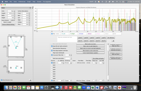

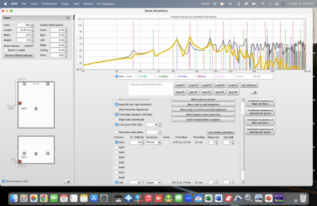

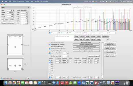

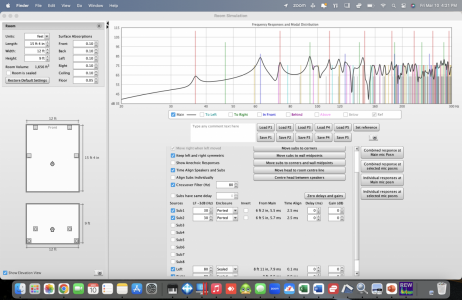

Based on your room dimensions, these will be the room modes https://amcoustics.com/tools/amroc?l=15&w=12&h=9&ft=true&r60=0.6
What kind of seating are you looking at, make sure the seats are atleast 2-3 feet from the back wall as well as there atleast 1 feet from the side wall as the surround speakers then are too close.
