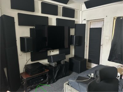

Avr over heats without ventilation and it’s normal. My 4500 even in open heats up like crazy for just 5-10 minutes of usage. I got ac infinity usb fans and it does an exceptional job. I now also have the avr with no ventilation on top as shown in image
Thank bro! After using cooling pad(as exhaust(on keeping the cooling pad over AVR air comes out)), heating is reduced at most of the places but at one place it is slightly more() may be 40 oC. Shall I leave it or do I have to do something more?
If there is no ventilation on that particular area it’s better you get ac infinity usb fans and place it. If you can source it from us when any of ur relatives or friends are travelling it’s very cheap. Buying from Amazon is little expensive but it’s worth it. I got a pair from Amazon India at almost thrice the original cost.
