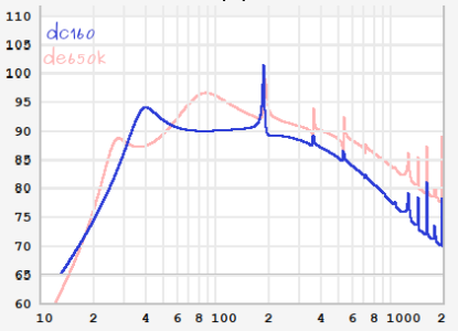

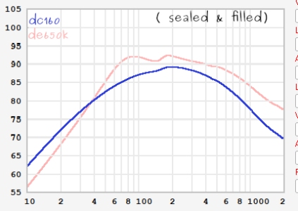

Qe is nothing but motor strength integration by the coil. The higher the magnetic strength the lower the Qe and the better the motor generally. Qms comes from mechanical damping of surround/spider etc, lets ignore for this discussion.
There are many variables, yes, true, but starting with a low BL, high Qts, high Fs driver is not a recipe for success.
Do OBs need a weaker magnet? Yes, compared to other alignments, pls read elsewhere. Horns, need very strong motor hence very low Qe/Qts (0.2-0.35), then comes ported(0.35-0.5), then comes sealed (0.4-0.7) and then comes OB/dipole(0.7 and higher). Just compare a few of each of these popular designs, the relation to Qts will be evident and is not by chance. Since you are into OB/dipoles, I will try to explain the high Qts/Weak magnet/OB connection, the dipole loss of OB needs to be compensated somehow, depending on baffle and driver size, of course, so generally what designers do is that they choose a weaker magnet (high Qts) which damps the resonance of the driver less than a stronger motor and thus lets the resonance provide a gain that compensates the roll off, atleast thats what the intent is. Thats why they choose Qts of 0.7 or so. Of course, nobody wants to call the driver, one with a weak magnet, but technically thats the case. Most of the local drivers have high Qts, its a sign of using cheap magnets to cut costs, which is why some DIYers import drivers. All magnets whether its Y30 or Y35, look same, so magnet size also does not tell the Qts. I have seen big magnets with poor Qts, means they are big for looks/marketing only.
