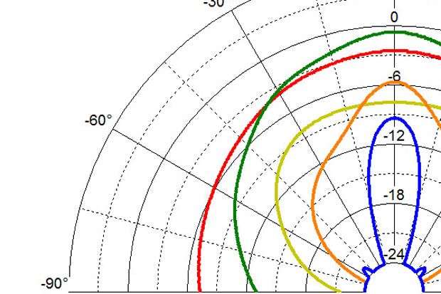

A lot of us listen to our systems alone, most of the times. And we sit at the sweet spot. I particularly appreciate narrow dispersion. At the sweet spot if gives strong imaging.

It’s fine to have a wider dispersion, but it should be uniform and similar to the on axis. That’s the real challenge which every manufacturer struggles to engineer.

Narrow dispersion when you want to make sure its a smaller and more precise listening position where it room behaviour is predictable due to treatment.
Wider when you want a wider listening stage .while Horns and waveguides are usually used to control dispersion and As @Passive_audio_enthusiast mentioned, its ideal to get a even dispersion but there could be a difference and Toe in is an option to adjust accordingly to get the right tonality.

I have a speaker which has quite narrow dispersion now. All my previous ones had very wide dispersion. It only sounds wide and room filling if the recording is done in a spacious way. Earlier I was in the middle of every song! I like both, I would have preferred it but wider but now the imaging is way better as you said. But probably it has more to do with the coax than the dispersion in my case
