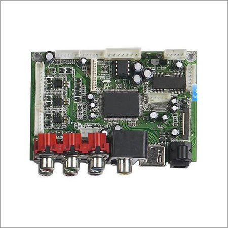

card is like this
that brd has MPEG decoder n controller,rf chip,dac ,4558d opamps X4..etc all done in smd all you need for a dvd player, some players have bigger thru-hole boards,for easy servicing
