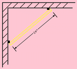

I think you should build simple corner bass traps.. More corners you treat better the sound will get.. tried and tested method..
From the Ethan winer article shared by @sound_cycle earlier, some critical points..
Generally speaking, most rooms need as many bass traps as you can fit and afford. Although it is definitely possible to make a room too dead at midrange and high frequencies, you probably cannot have too much low frequency absorption. The effectiveness of bass traps is directly related to how much of the room's total surface area you treat, which includes the walls, floor, and ceiling. That is, covering thirty percent of the surface with bass traps reduces low frequency reflections far more than covering only five percent.
At the minimum I recommend placing bass traps in all of the corners. For even better results, put additional traps on the walls and optionally on the ceiling.
Note that two adjacent two-inch panels absorb the same as one piece four inches thick, so you can double them up if needed.
Besides the corners where two walls meet as in Figure 3a, it is equally effective to place fiberglass in the corners at the top of a wall where it joins the ceiling.

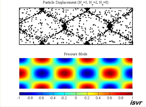

Here is visual pic of room modes from net..
A weird thought- Am visualizing this from ceiling, thinking what if i could make more partitions in the ceiling and absorp where the pressure is more.. (Exclude the cost factor for now).. Weighing if the option would be more effective in absorption..
