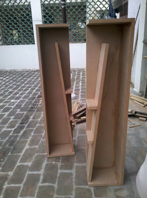

The enclosures needed a little manipulation as the speaker I was using was a 5.25 and not a 5 one.
These enclosures were made by a skilled carpenter, I would have made them... but I did not have proper power tools to work with, and working with a hand saw to cut a 18mm MDF board was not what I would want to do !!
After two days of carpentry, the enclosures were waiting to be wired. I used a 12mm thick foam to acoustically insulate the sides of the enclosure and filled with some puffs of poly fill in certain areas.

Great Wood work and images. If i understand the images correctly, it seems the open end has a larger cross-section area than the closed end and you will be using some kind of port for the terminus or may be mass loading the line. The line is tapered and the driver is off-set at 1/3rd of the total line length. Take care of the back pressure from the woofer due to lower cross-section area just behind the driver as this might cause standing waves right behind the drivers. Needs to be intelligently damped. How have you calculated the damping requirements for the line? Will be interesting to know.:clapping:

Yes, i actually screwed up a little on one of the cavity for the mid bass driver. I bored in a little extra. Had to fill up with m-seal ... you might have seen a picture of it in the collection. after it dried, i used a file to make a perfect circle.:)

I went through the link, but this project was meant to be used with the Fostex driver. Hope you are also using the same driver or a driver with similar TS parameters. The line length, damping coefficient and cross section area varies with the driver and cannot be directly substituted. The harmonics will not match with the acoustic impedance and you will need to experiment with the damping in case you hear some mid-range anomalies. The acoustic impedance is important to have the low frequency lift you get from the line length or you risk having standing waves in the line.
