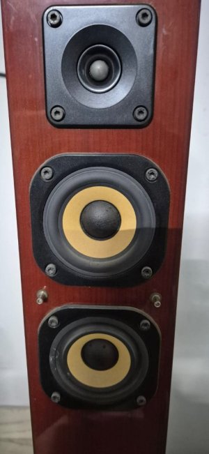

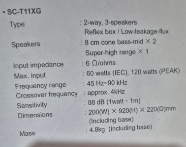

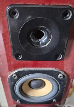

Here are some pictures:
1. Damaged tweeter of Front left (I have cut wire of tweeter, and using the speaker)
2. Good Front right
3. Front tower Denon specs
Can this tweeter be changed or repaired by local electronic shop? I am in Noida but don't know anyone good.

That’s more like a destroyed tweeter it appears, than a damaged one. Better to contact the company for a replacement tweeter.
