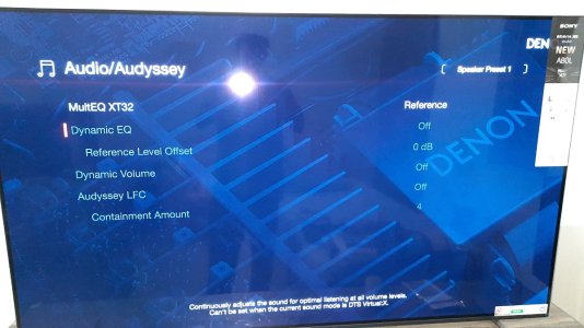

no room acoustic done and will add sub soon. can you tell why they feel low volume below 75 and aabove 80 it sounds like a theatre. did audessey setup did some thing wrong/
Go to settings-Audio-Volume-Scale change scale to -79,5db -18db
Limit -5db
Power on level -40db
Mute Level Full
This is what Iam using on my maranz 50.
Here zero is rederence 75 db
Check volume from minus 40
Minus 40 means 75-40 that is 35
Like that check.
May becat -30 or -25 you will get good volume.
And in ootions in avr remote adjust the channel levels.
Multiwq xt 32 put FIAT.
try these.
Enable Dynamic Eq and listen at Low volume.
In general my listening volume is between -25 to -22.
Some times for music -34.
As yours is also non accoustically treaed room dont put high volumes like 75.
