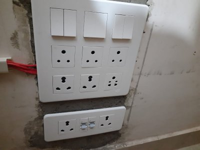

finally from mains service line and mcb i did my connections. Subwoofer 2 sockets and switches have separate 4mm line and tv 4k player appletv denon have separate 4mm line from mains

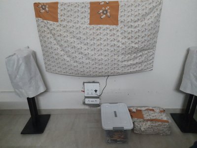

Finally tv wall mount done now i have space to try subwoofer many places and now can place beween speakers easily
I will open bottle only when i am done with subwoofer placement alignmnt with room eq wizardd

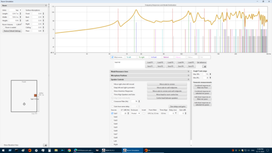

hi i found best place in rew room simulator do you find this best and flat for subwoofer. Till 120hz its good and flat and beyond 120hz does not matter. do you agree?
Change the spl limits to 40db - 130db and then see if it is actually flat.
i am confused about the measurements from wall. Do we have to consider subwoofer cone which is in front? To measure how far it is from wall? or full cabinet of subwoofer. Its all confusing me. If u seee the image below it can face towards my chair but it can also face my left wall. no?
Just use the front of the sub cabinet to measure distance to front and back wall and centre of sub for right to left. The rotate option can be used by right clicking on the sub box. Also your sub's -3db point is 16hz in ported and 17hz in sealed.

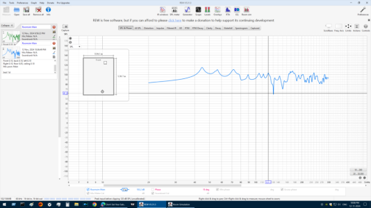

i ran room eq wizard today. my pb 2000 pro went till 12hz when i placed in front right and facing right side. but as usual have null in 70 to hz what to do?
