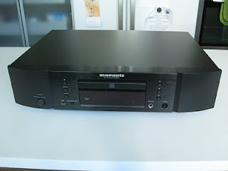

The CD6003 is quite a handsome player and has good build and heft (slightly over 5 kg). The chassis is fairly rigid with a double layered bottom plate and compared to the SA8003, the immediate giveaway in cost cutting is an extremely flimsy CD tray.

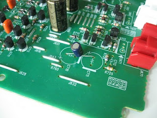

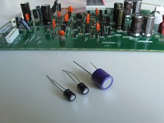

Over the years in modifying Marantz CD players, the most dramatic difference in my humble opinion comes from upgrading the DC blocking capacitors. So far, the Marantz players I have handled (63, 17MkIII and now the 6003) use a pair of Elna electrolytic caps back to back to make them non polarised. Usually I bypass them completely after determining that there is no DC offset. Unfortunately this time around, DC offset was quite high at 150mv. I don't usually try film capacitors in this location due to space limitations and the high value needed to avoid bass roll off. So, a pair of 6.3V 22 uF Rubycon Blackgate HQ NX non polarised caps were used to replace the existing 4 Elna Silmic caps used. I also usually remove the muting transistors, but decided to leave them alone this time.

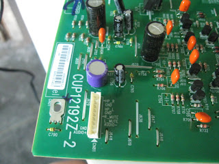

Next, came the digital power supply to the CS4398 DAC. The local decoupling cap was changed from a 100 uF Koshin cap to a Sanyo Oscon cap of the same value. The stock circuit bypasses this cap with a small ceramic cap which I left in circuit. I have very good experience with the Oscon in digital power supply decoupling and cathode resistor bypass applications.
