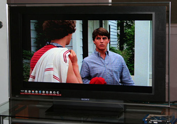

i dont think i'm being able to explain this. wait i'll show you a picture
in this pic, you'll see that although the video is of an original dvd , the picture isnt full screen. there are two bars on the top and the bottom of the display. thats what i'm talking about.
thanks for ur reply. but my default setting is 16:9. when i watch divx/xvid videos the video covers the entire screen, but when i watch dvd content (4.5gb stuff with .vob, .bup and .ifo files in it), the screen produces a "cinemascope" effect with two black bars one on top and the other in the bottom.
here's one more pic of how an original dvd looks on an lcd.(from lcdtvbuyingguide.com)
i hope you can see that video aint covering the entire screen space.
I think most of the Hollywood movies are "wider" than the 16:9 wide mode.. so we would still get those black bars though the bars are thinner than in a 4:3l TV. Somebody correct me if I am wrong ...
i completely agree with u on this.
when i watched those dvds on crt, the black bars were huuuuuge. the picture size was tiny, to say the least. on the lcd, the black bars are narrower, but its still there. :(
lcds and plasma still get black bars when playing that annoying hollywood formats such as 2.35:1,2.39:1 .so blame hollywood.

Here is something as a background info:
Black bars are normal on your TV under certain circumstances. This is because the programmes shown on TV were originally shot in a number of different aspect ratios.
Movies shown in theatres are typically shown in a wider ratio (1.85:1 - very close to 16:9) - or they can be shown in 2:35:1 (a picture much wider than tall)
One way that this has been dealt with is with "pan and scan", which involves removing pieces of the picture to fit the screen. A whole bunch of movies are pressed in their Original aspect ratio (OAR) - as the director intended - mostly widescreen. These are the movies that create bars above and below on standard TVs. The programming shot for standard TV's creates bars to either side of the image on widescreen TVs.
Here are some basic descriptions of the various "black bars":
  • 16:9 High Definition Programming:
True High Definition Programmes are 16:9 and you will see no black bars on your widescreen TV.
  • 16:9 High Definition Programming, originally shot in 2.35:1 aspect ratio (2.35:1 OAR).
Some movies will be shown this way and it is normal to have black bars above and below the movie/programme. Most TVs cannot properly stretch HD images, so you are "stuck" with the black bars.
DVD players have a menu for selecting "widescreen or 16:9" TVs. This should be set to 16:9 or widescreen when watching DVDs on a widescreen TV.
  • 1.85:1 Enhanced for Widescreen (Anamorphic) DVDs
These DVDs are the correct aspect ratio to fill a widescreen TV. You will need to set the TV to it's "horizontal only stretch mode" to properly see this type of movie. There should be no black bars (or the black bars may be very thin). If you use the vertical and horizontal stretch mode by mistake, everyone will be tall and skinny. Many newer HDTVs do this automatically.
  • 1.85:1 "Standard" DVDs (Not Enhanced for Widescreen (non-anamorphic))
These DVDs are the correct aspect ratio to fill a widescreen TV. You will need to set the TV to it's "horizontal and vertical stretch mode" (zoom) to properly see this type of movie. There should be no black bars (or they can be very thin).
  • 2.35:1 Enhanced for Widescreen (Anamorphic) DVDs:
These DVDs have an aspect ratio that is much wider than it is tall, so it will not fill a widescreen TV. You will need to set the TV to it's "horizontal only stretch mode" to properly see this type of movie. There will be black bars above and below the movie. If you use the vertical and horizontal stretch mode by mistake, everyone will be tall and skinny.
  • 2.35:1 "Standard" DVDs (Not Enhanced for Widescreen):
These DVDs have an aspect ratio that is much wider than it is tall, so it will not fill a widescreen TV. You will need to set the TV to it's "horizontal and vertical stretch mode" (zoom) to properly see this type of movie. There will be black bars above and below the image. If you absolutely cannot stand the black bars, you can use the DVD player's zoom mode to zoom in on the picture and eliminate the black bars, however, you will now miss the "outermost" parts of the movie and you will not be seeing what the director intended.
  • 1.33:1 DVDs
These DVDs are the correct aspect ratio to fill a 4:3 TV. You will either see bars on the sides, or you can use one of the stretch modes like you do for any standard definition signal.

As I mentioned in my note, enhanced for widescreen can come in 2 ratios (1.85:1 or 2.35:1). For one you will get black bars and not for the other AFTER you set your DVD setting to widescreen mode.
The way to recognize this is that DVD covers have the info printed on top usually at the top. Also another simple way to remember when you see the titles is
non-anamorphic = letter boxed = black bars on top/bottom
