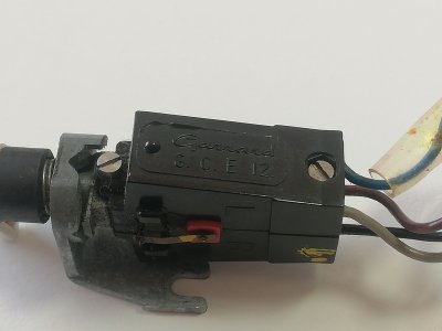

I understand that this solution will not please the most purists but it is for me the most practical. It also allows me to use the Garrard with any of my equipment.

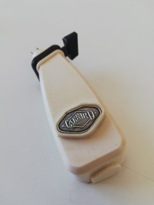

The changed capsule looks like the original, 60 years later! It has been replaced by a SHURE M44MB.

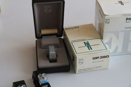

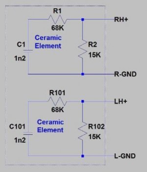

One of the most interesting ceramic catridges that I have come across is the Philips GP390. The cartridge body actually houses a little PCB with the inbuilt network (per the diagram below), enabling compatability with any generic input:
View attachment 74242View attachment 74243

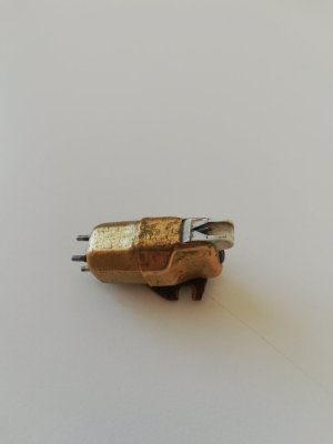

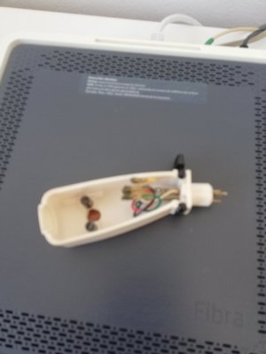

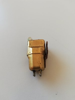

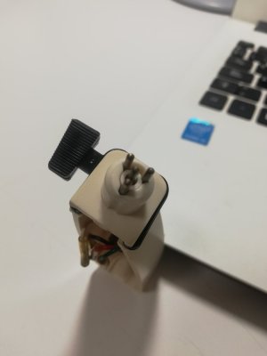

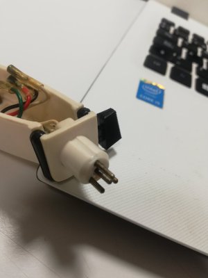

Received the second headshell. With a cartridge without brand, unknown to me. I will now have one with ceramic capsule and one with magnetic.
Warm regards.
Warm regards.
Nice, that cartridge looks very much like an Empire 880 series moving magnet cartridge to me. These were high quality cartridges for stereo turntables with precision tonearms. Tracking force was from about 0.5g to 3g which is beyond the capabilities of the Garrard RC210's tonearm. Looks like you have a 3-pin headshell version which was the matching headshell for the Garrard TPA12 tonearm commonly used as a stand-alone tonearm, or alternately as the integrated tonearm on models like the Garrard 4HF Turntable and Garrard Type A Record Changer. The RC210 tonearm uses a 4-pin headshell.
It’s the 4 pin headshell version. If it’s an Empire 880 cartridge, I guess finding needles must be almost impossible.
Warm regards.

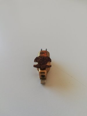

Warm regards.
Sorry, could not notice the 4th pin on the earlier pics. Also an amendment to the above post-the TPA12 accepts both 3-pin and 4-pin head-shells.
It's the S880 series stylus that you would need and should be easily available online. Here is a vintage sample.
However, one point to keep in mind is that a replacement stylus of high quality and repute is usually as expensive as the cartridge itself, if not more expensive.
View attachment 76005View attachment 76006
Indeed, it is an Empire 880 cartridge. You are a master of high fidelity! I've found needle spare for 28€ more shipping. Maybe it is a good idea to have a cartridge like this in working order. https://www.dacapoaudio.com/1678-Empire-Scientific-S880-P-styli.html
