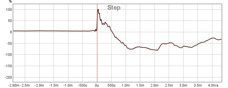

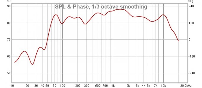

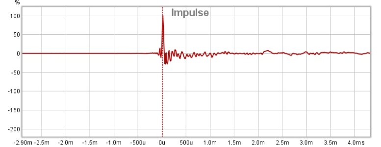

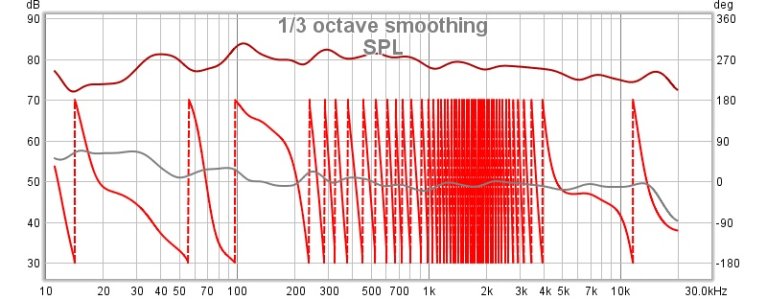

Could finally complete the OB speakers after padding at the rear side for reducing panel resonance. Also did a quick measurement as below.
The measured FR at listening position - The minimum phase is quite zero phase till 10KHz.

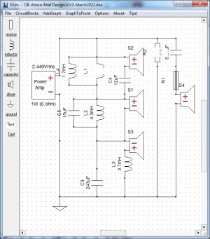

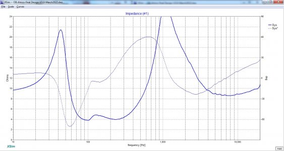

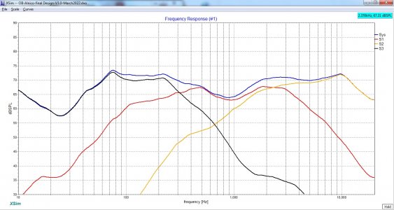

Took around 2 months to measure, design, assemble and fine tune the speakers. I re-designed a 3-way speakers from these drivers. It's a -12dB/ octave design. The topology is Hybrid crossover. Don't know if anyone building these design. The 2 x8" driver and 12" Alnico are in series crossover configuration and the 3" Telefunken Alnico's are in parallel to them. Impedance wise they are ok for this topology.. The crossover points are 300Hz and 3450Hz. The OB delivers till 60 Hz -3dB where the subwoofer adds one more octave below. I at times don't turn the sub on depending upon the gener of music that I am listening as I am not a bass head and shall prefer overall coherence and transparency over more bottom end.
Shall post images as time permits.
Posting some simulated and measured images for the benefit of DIY community

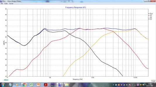

The below are the simulated results from the original design last month,

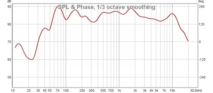

From the above simulation, below is the measured results,
There was an increased energy in the mid-range in subjective listening from 700Hz till 3KHz region as confirmed by the measured results. I needed to fine-tune to reduce this shout in the mid-range. Interestingly the simulated response displayed flat response though.

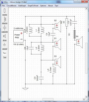

Modified cross-over after fine-tune:
The simulated response show a deep null from 300Hz till 2KHz but the below measured response is somewhat flatter at the mid-range.
The subjective listening also gives a more mellow response with a smooth presentation of the midrange without any masking of any frequency.
