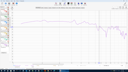

great SPL at 12hz in my room
Is this worth to get 105dbfs at 12hz in my room for pb 2000 pro. I changed position of my sub yesterday and curve got better but spl also increased from 90 to 105 at 12hz. Can we really hear 12hz ?View attachment 91286

The fact that the level of 12 Hz in your room increased with simple relocation of the sub woofer, points to the new position creating a room resonance.
110 dB to 115 dB in your room, from 10 Hz to 100 Hz is highly undesirable... especially on a regular basis.

but relocation gave me very much better curve. Still have to think about 70 to 76hz dip of 10db though. But tell me one thing as i have moved subwoofer away from fronts why dirac bass control still kept distance 0 ms for sub and 3.60ms for speakers?
PB2000 in simple words cannot produce the sound without distortion, check waterfall graph in REW. I don't want to discourage you, PB2000&3000 aren't very capable subs. If you really wants to experience SVS, that starts from PB4000.
