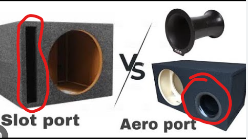

What you are looking for isn't possible..
16hz extension will have severely sacrificed bass in the 40-80hz range..
And expect port noise...
