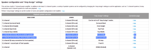

For ceiling mount Atmos speakers, what amp assign settings do you use in X2300 AVR as it has only two option available for Atmos (Front Atmos or Surround Atmos) ?
It depends upon the place you are placing the speakers. I have fixed my two atmos speakers one fit forward to my listening position and assigned as top middle in the AVR settings.
Shouldn't the three option above the two you have highlighted also work?
Scrolling down this page gives the many options available, visually.
Of course, Denon's terminology is terribly confusing, but the diagrams are a bit clearer.
Could also be my mistake reading it wrong. So, please take it with a pinch of salt.
Thanks Manoj for clarifying it. I hope you're getting Dolby Atmos effects sound in Top Middle speakers using Top Middle 7.1 configuration as suggested in the manual?
You're right, it is confusing for me in the manual.
Though manual had provided diagrams and configuration for Top Middle speakers, I have impression that it will only work for Dolby Digital 7.1 signal and Atmos sound may not be redirected to Top Middle Speakers.
U need to understand itcorrectly. The Dolby Atmos ( front & surround speakers ) mentioned here is for bouncing type model ,i.e speakers with upfiring model which are kept on either front or surround speakers.This will create a pseudo atmos sound ( by reflecting sound from ceiling upfired by that speakers).
For proper Atmos sound,this is not recommended. U may need to mount the speakers either on ceiling or high on walls with repeat to the angles mentioned in Dolby Atmos specifications/ guidelines.
Thanks, it cleared my doubt!
