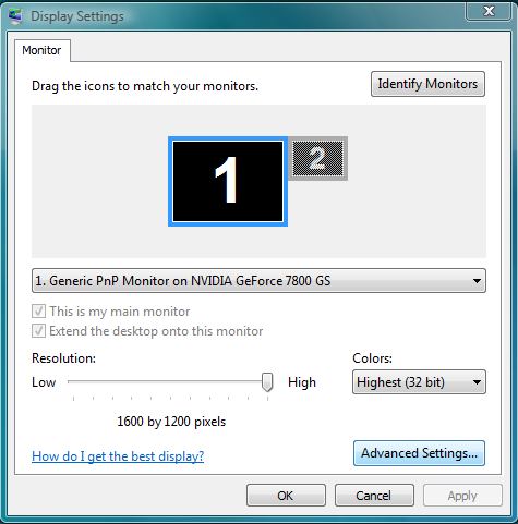

In case you want the second setting (i.e. 1080p on TV), you need to set the 4th checkbox named "Multiple Displays" to "Extend these displays".
Once you apply above settings,
you will be able to set the resolution of laptop and HDTV independently by selecting Display "1" and "2". Display "2" is disabled unless set to "Extend these displays".
You are currently using "Duplicate display" mode. In this both screens must have the same resolution. So Win7 chooses the least resolution among the two. In your case its laptop's resolution which is less and thus imposes that resolution on TV. When you close the lid, laptop resolution is no longer the constraint and thus Win7 switches to 1080p which is native resolution of TV.

More about Extend mode :
In this mode, each screen will have its own native resolution and it acts as if two displays are stitched together on their sides. So when you move a window sideways, it will move from one screen to other as if the 2nd screen was part of 1st.
In this mode you can set one of the display as "Main Display". Here is how.
I generally use the extended mode as HDTV runs in full 1080p. When watching movie or browsing, I drag the browser or VLC player to the TV screen and then go full screen. But I use a Mac. But same thing must happen on windows.
Also in extended mode, you may be able to set the way the two displays to be stitched. i.e. As you observed, moving the window/cursor to the right made it move to TV. You can make that transition to happen when you move either on top, bottom, left or right. If you set this based on your physical positioning of two displays, the transition becomes intuitive.
If I am not wrong, opening back the laptop lid should cause the TV to switch back to laptop resolution as it is again the limiting(least) resolution of the two.
