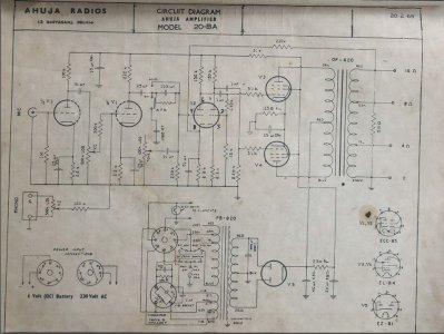

Help needed to restore Ahuja TM 50

You may have some open questions in your mind about how to identify OP transformers, how many tubes to use in a push pull arrangement with a typical transformer type, importance of biasing in tube amps, tube rectifier vs solid state rectifier, if I drop the number of EL84 power tubes from 6 or 4 to 2 then can I use the same OP transformer, can I modify the Ahuja circuit from PA frequency response to Hi-Fi frequency response ranges, etc, etc. The good thing is that tubes like ECC82, ECC83, EL84, EF86, EZ80, EM84, ECL82, etc are all very commonly used even today and hence there are tonnes of circuits and related information available online.
Ps: Anything to do with tubes requires knowledge of electrical wiring, the ability to work with point to point wiring, the ability to solder well, use of test and measuring equipment, understanding of risks and safety rules, the ability to calibrate and the ability to troubleshoot. Working voltages start at around 270volts-300volts and can go much higher. For example, a Music Man 112 RP 65 guitar amp has a Power transformer which delivers an output voltage of 700volts.
@VikasG0791 I am not trying to dissuade you here but building a tube amp from scratch by referring a schematic is a big pain. Troubleshooting skills are needed for a fresh build of any amp, and more so when you are using used parts.
What is the guarantee that your donor chassis and components are all good? Filter caps go short, Other caps change values, resistors open, tubes will already be burnt-out or microphonic or red plated or will display these issues only when the amp is taken out of the series lamp. I have seen all these problems in just 2 amps I purchased, and also one of the tube socket was shot and I had to replace it.
