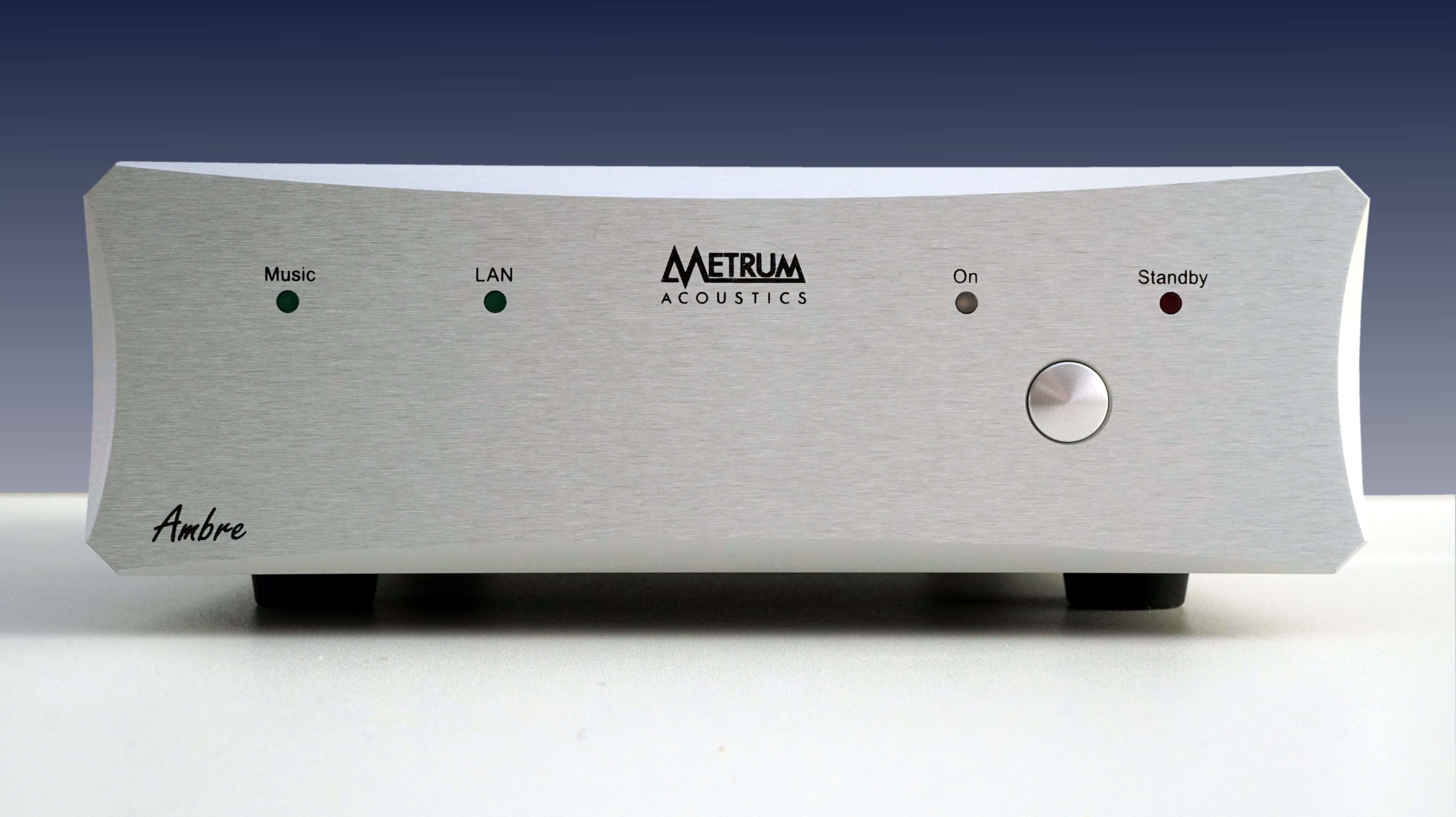

Need help from users of Metrum Ambre.
Helping a friend to bring it up and running.
The OS got corrupted for some reason and after installing ropieee and picore we are getting stuck at what to chose for audio devices.
So wanted to know from users what is chosen for them or how to enable i2s audio.
The Ambre has a special hat connected to the raspberry Pi via i2s and enables it to output digitally to dac by i2s ethernet or Bnc.
Have also written to Metrum for the link of the ropieee image which works with Ambre but as usual the response is slow and I don't see them replying soon, so if any existing Ambre user can help it will be great.
One advise I will like to give to existing users is to make a backup image of the sd card so you can restore it without fuss if the sd card gets corrupted for any reason.
Thanks

No help from Metrum.
Since five days trying to reach them by email and twitter but there is no reply.
And this is just for the download link which God knows why they can't post it on their website.
How much ever good your products are , If you don't have time to reply to your customers then the company is no good.
In my friends case they just have to send a link, that's it.
Writing to Mr.Cees at Sonet (his new venture) did get the ball rolling.
Although Metrum staff do claim that they had written to my friend but maybe the email was not received.
Long story short, it took two minutes to install the custom image of ropieee and everything started working as it should.
Will keep the image downloaded for future use as the SD card can get corrupted anytime.
Will advice other users to do the same.

Thanks for your reply
Issue has been resolved and Ambre is working perfectly now.
Someone from. Mr. Cees office sent the link with new image.
Amber does not belong to me but no other OS would work as only the one provided by metrum recognises the hat board

I installed volumio on my ambre and The blue light keeps blinking. The green light, however, turns on only whenmusic is streamed to the ambre. I read on another forum (forget which one) that the blue light only works for ropiee.

I've applied a very small black tape over the blinking LED.
One user on headfi thread has mentioned how to switch off the blinking blue light using command line.
Don't worry about blinking light. Nothing happens to Ambre. I'm using custom linux distros since 2yrs. No issues till date
