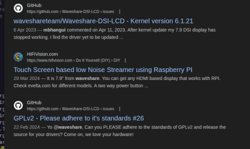

This will not work because droverlay=waveshare35b-vt is a proprietary driver. The problem that you have is that moode, volumio and all such distributions have taken a raspberry pi image from some particular date. So it's version is let us say 5.x.2. By installing moode you are now stuck at 5.x.2
Meanwhile the official raspberry is at 6.15.3
Then comes a company like waveshare who take a open source code for their driver, modify it and make it closed source. Because of this the driver works on on 3.x, 4.x, 5.x, 6.15.1 Everytime there is a new kernel release their driver stops working.
To make it work you can do only the following
1. Ask Waveshare to release a driver for your old kernel version 5.x.2 used by moode. To know the exact old version used by your moode applications, execute the command uname -r on terminal.
2. Ask moode to give you a moode build for the kernel version on which waveshare works. You will have to follow each and every step in the waveshare site. This will give you a particular old kernel version on which waveshare works. After installing waveshare driver you will have to do uname -r on your terminal and then ask in the moode forum on how to get moode working on your kernel version where waveshare version works.
3. Build moode yourself. I believe there is a way. But you will have to learn lot of linux.
4. Use the official opensource driver like me by using dtoverlay=vc4-kms-v3d and see if that works.
This is one of the reasons I avoid builds like volumio, dietpi, moode like a plague. None of them have released their software as a debian package. They all release their code on fixed raspberry pi versions.

The easiest thing is to use
Instead of
dtoverlay=waveshare35b-vt
and see if it works.

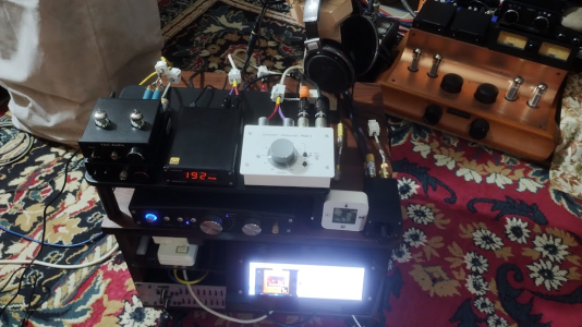

Picture 1: The portable streamer on wheels. The whole ugly thing has wheels at the bottom can can be moved easily between rooms. All audio output is on ethernet sockets and can be quickly connected to any amplifier in my bedroom or music room using simple ethernet cables. It also has a low pass subwoofer output that is wirelessly sent to a subwoofer in the room.

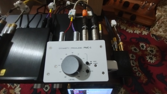

Picture2: USB volume control
I capture the USB events using a small program written in C. It can increase/decrease the volume. Single Press pauses the song. A press again, unpauses the song. Press and move it clockwise to increase the rating of the song. Press and move anti-clockwise to decrease the rating of the song. Along with the rating and how I listen to the song is captured in a database. I then use AI to dish out playlist of songs that I prefer.

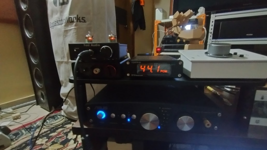

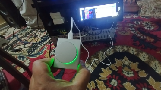

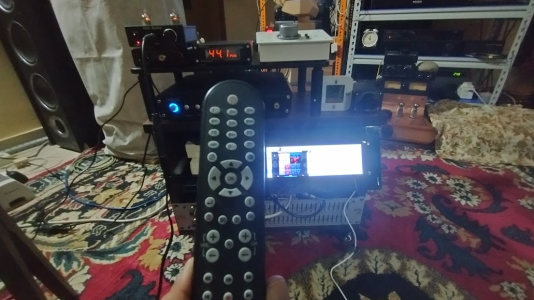

Picture 3: IR remote control

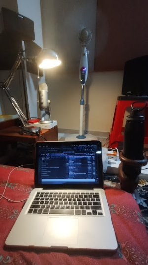

Picture 4: Volume Control of balanced outputs

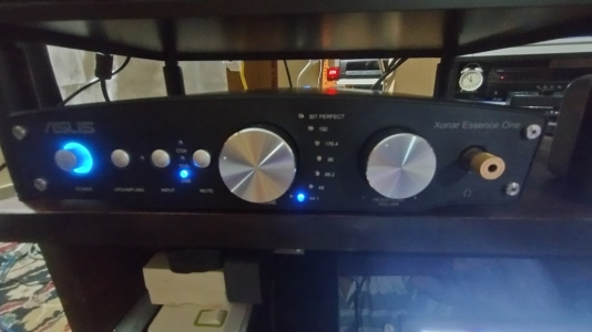

Picture 5: Headphone Amplifier

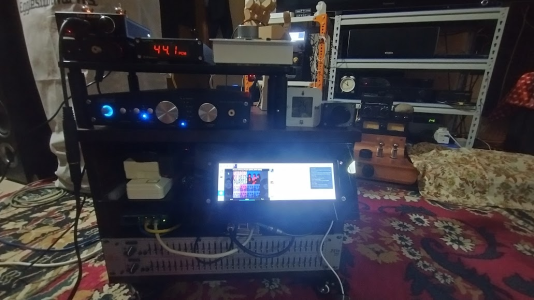

Picture 6:
Vacum tube based Headphone amplifier based on GE JAN 5654W. Here JAN stands for Joint Army Navy. This is a rugged tube that was made many years ago jointly for the US Army and Navy by GE. Below the Tube Amp there is another headphone amp Toppings L30 Headphone Amp. Apart from this there is another headphone AMP, the famous O2 amp that made companies like Schitt run for their money. The O2 and the above Asus are the ones that I prefer the most

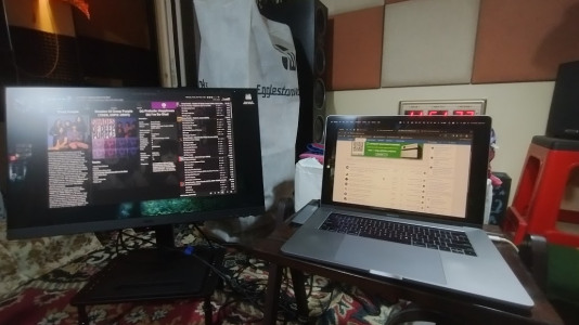

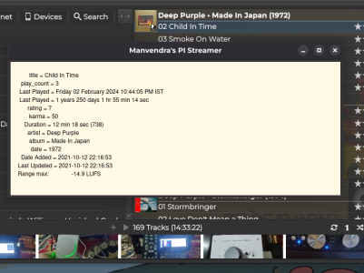

Picture 7: The same display on the small RPI touch screen being projected on a large Monitor along with cover art. There is lot of other information that gets displayed
1. Song information (Album, artist, title, date last played, play counts, song rating)
2. Dynamic Range, Sampling Rate, Duration, etc of the song
Picture 8. Song information displayed

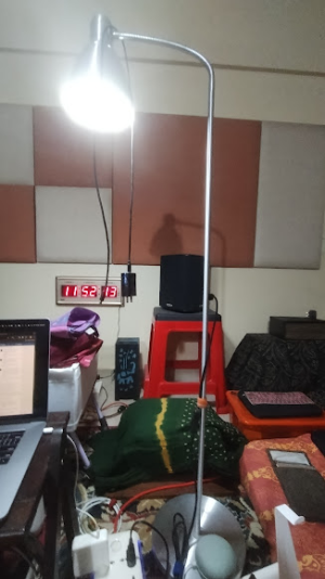

Picture 9. Table lamps, Floor lamps and wall lamps, Fan controlled by the portable Rig, by clicking buttons on the Raspberry PI GUI using a low energy bluetooth dongle.
I will put down how each of these controls can be achieved by anyone using material easily available on Amazon India. All source code written by me will be made available on my personal github account. How to wire all this and put all this together will be written in next few posts. The kernel tweaks made to achieve low latency will also be detailed. Watch out this space.

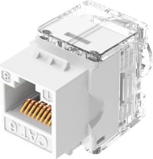

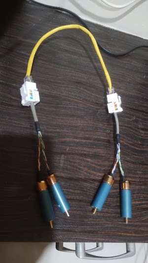

What are those white plastic clips on the cables? Ferrite cores?
Those are keystone jacks. You can punch down cat5/6 cable with 4 twisted pairs into it. One end of a cat 5/6 cable goes into the jack and other end goes to a RCA plugs or XLR plugs. Since there are 4 pairs I can carry 4 channels of stereo in that or carry two channels of Balanced output through that. So all my equipment is connected using this. To connect the source to the amp I just need to plug in an ethernet cable between two keystone jacks. It makes it easy connecting and removing dacs, headphone amps, amplfiers between equipments.
I have written about this DIY approach of using ethernet cables to route audio instead of using XLR or RCA cables between equipments here in the post https://www.hifivision.com/threads/fully-extendible-rca-cable-over-ethernet-cable.97926
an example of a RCA cable using keystone jack is below. This DIY approach allows me to have RCA and XLR cables of any length by changing the ethernet cable length.
