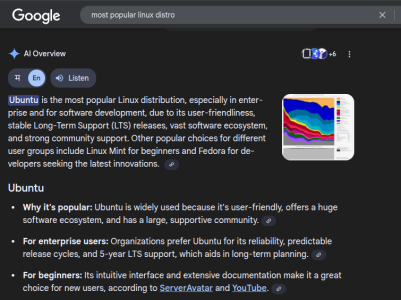

You are welcome any day. BTW Ubuntu is the most popular Linux distro
