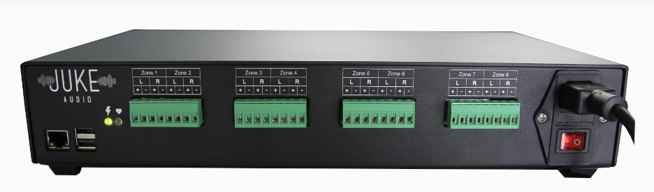

I am also interested in having multi room streaming system at my upcoming home. So far I have understood that I need a multi channel amplifier with multiple zones depnding on the need (6 or 8 zones) and the source is streaming via AirPlay or Spotify Connect etc.
I know two products one is from Control 4 and another is Juke Audio, shown below.
The specs of a multi channel amplifier are like 6 zones and 12 Channels or 8 zones 16 Channels.As shown in the above amplifier, there are 8 zones and 2 channels per zone.

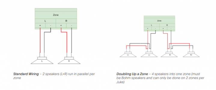

What if, I have a big room and I want more than 2 speakers in a zone? Do I need to create multiple zones in the same room? I am bit puzzeled on looking at the user manual. Can some one please explain the below how to add more than 2 speakers per zone as per below image?
My understanding is that, extra pair of speakers can be added from the left and right speaker itself as shown in the right hand side image and as the note says this can be done in 2 zones only. Is there any other kind of amplifier as well that supports more than 2 speakers per zone?
